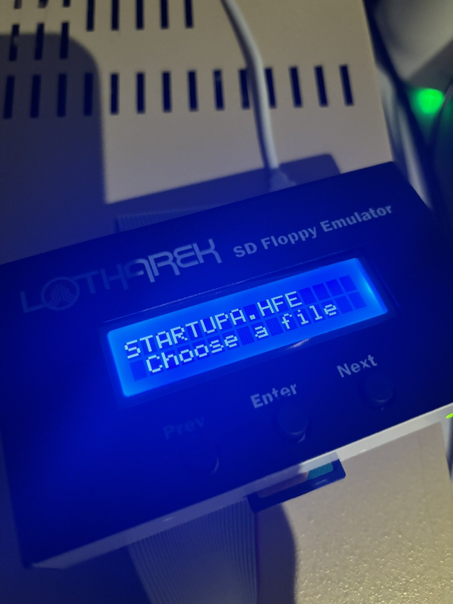

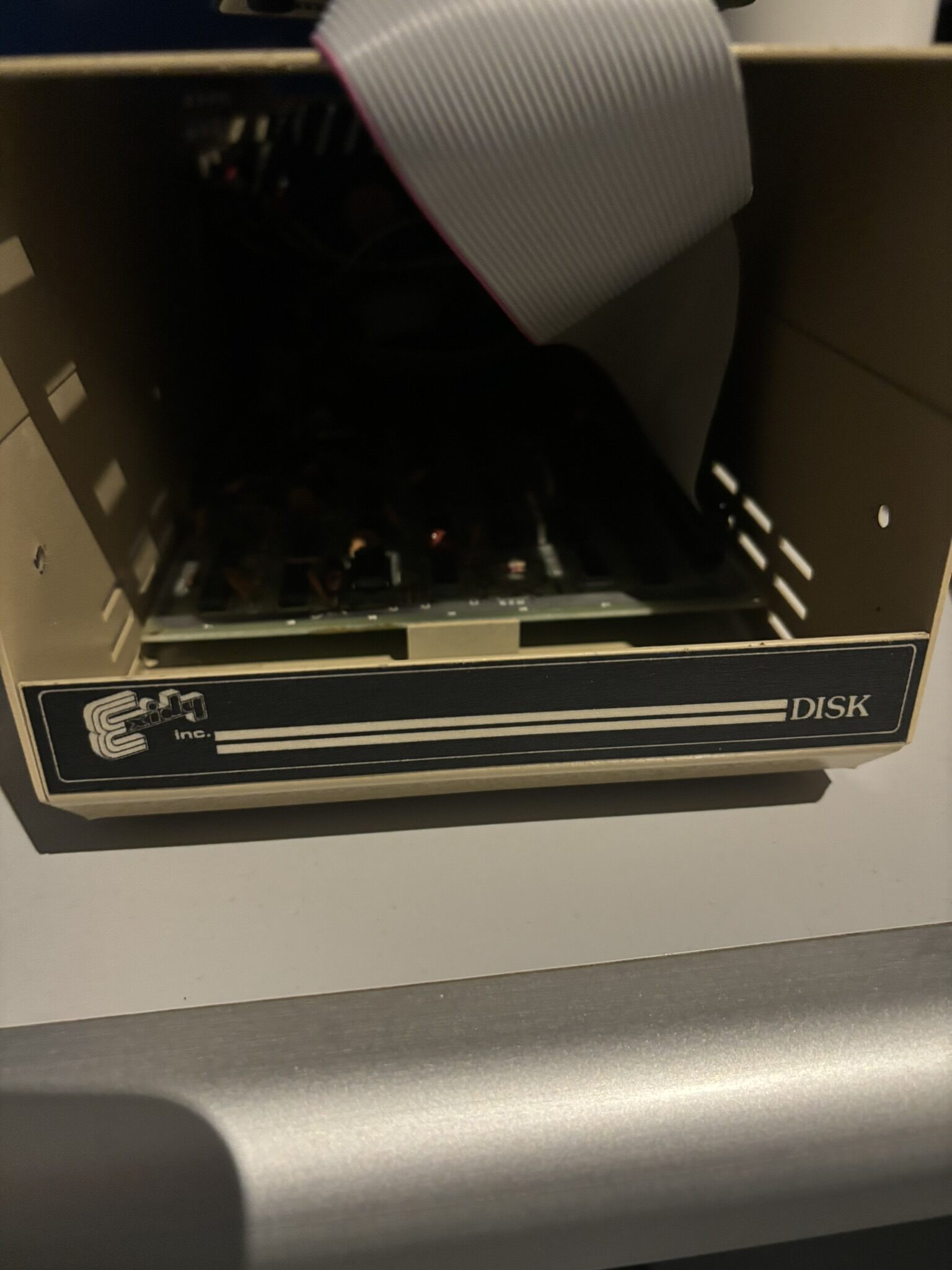

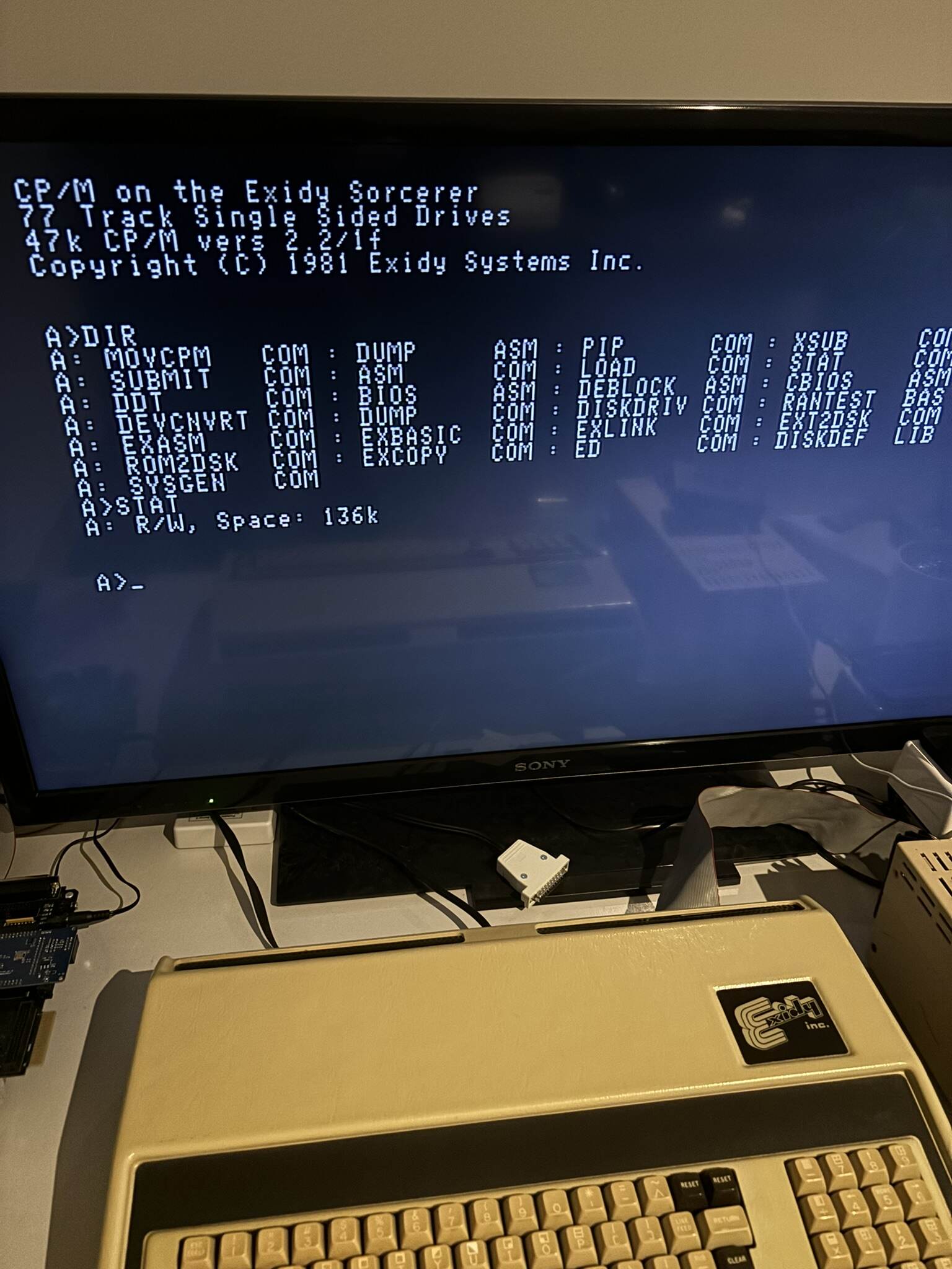

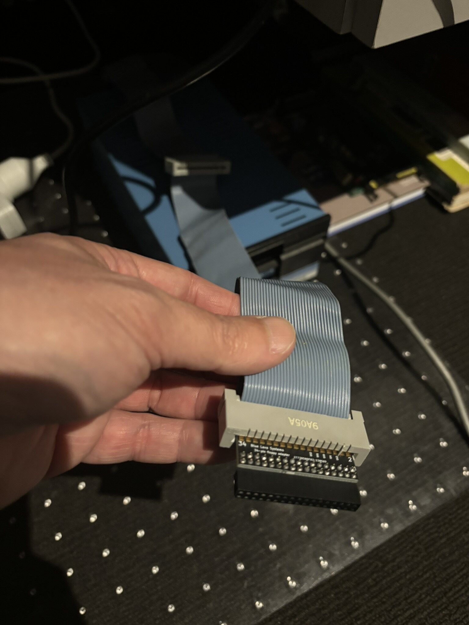

I have connected the Exidy FDS disk controller to a Lotharek SD Floppy emulator using a 77 track single sided Exidy FDS CP/M disk image that was supplied by Exidyboy.
Well it works 100% and boots perfectly and also reads and writes.

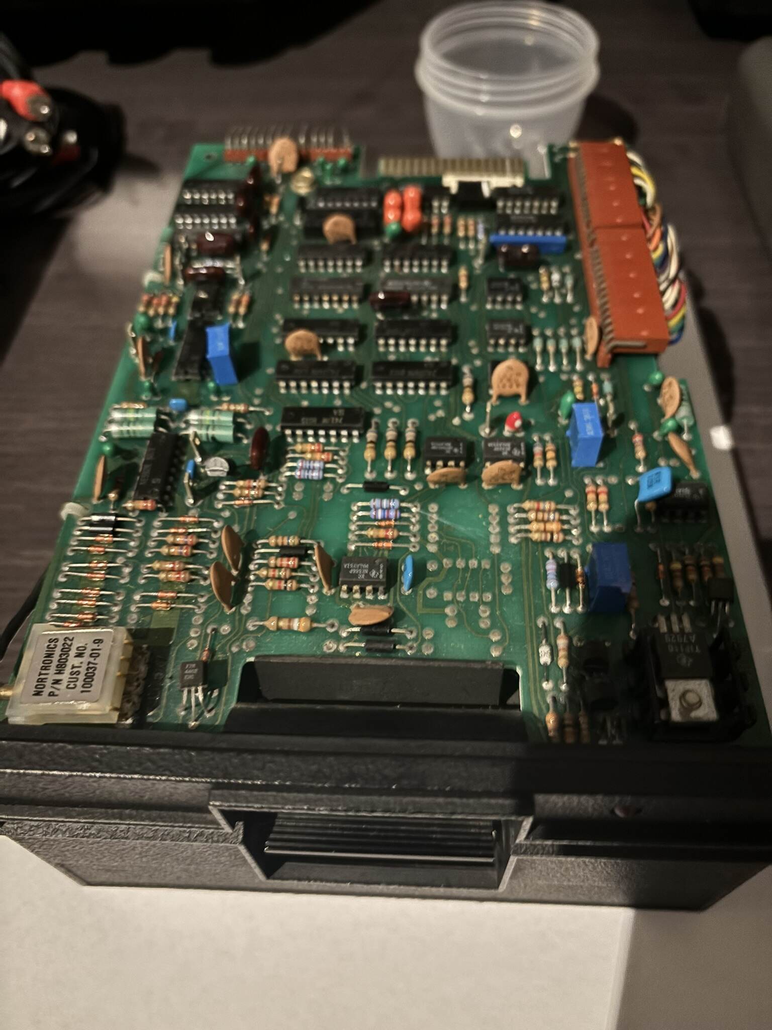

Next step is to connect a real micropolis 77 track 100 TPI 5.25" drive unit on the same floppy cable as the SD Floppy emulator and try to copy/create a real 5.25" Floppy Disk image.
i.e. SD Floppy emulator drive 0 and 5.25" Micropolis drive 1.

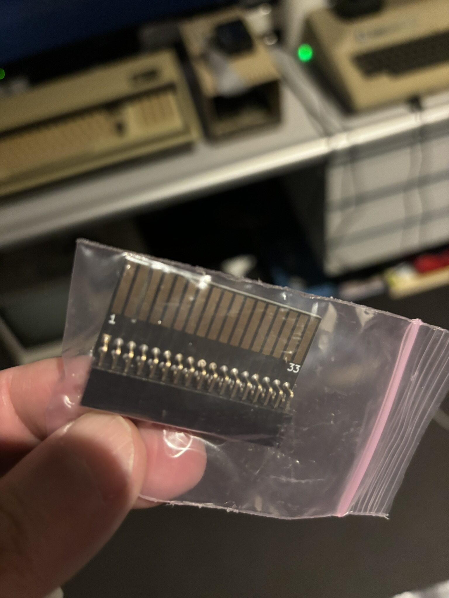

I have some 34 way IDC to 34 way edge adapter PCB's from Blue Lava Systems. This will allow me to connect the SD Floppy emulator (34 pin IDC) on the original Exidy FDS 34 way edge floppy drive cable.

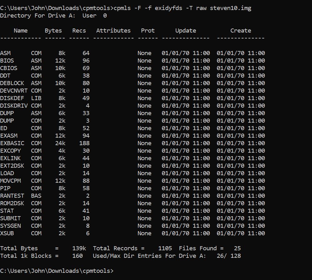

Thanks for previous work from ChickenMan, RedskullDC and exidyboy - I have managed to use Windows CPMTOOLS patched with Exidy 77 track FDS diskdefs to list and extract files from the raw disk image.
# Sorcerer FDS 5.25" SS DD 77T
diskdef exidyfds
seclen 128
tracks 77
sectrk 32
heads 1
blocksize 2048
maxdir 128
skewtab 10,11,20,21,30,31,8,9,18,19,28,29,6,7,16,17,26,27,4,5,14,15,24,25,2,3,12,13,22,23,0,1
boottrk 2
os 2.2
end
