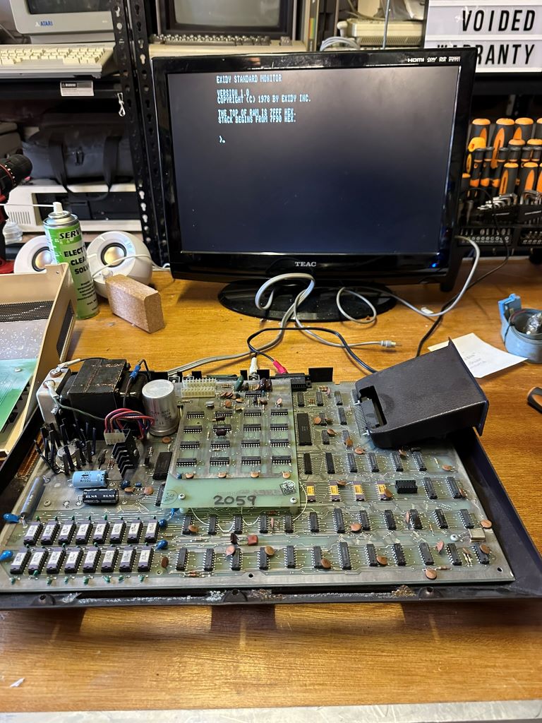

Although I have a reasonable collection of vintage machines, one grail item has always been an Exidy Sorcerer and as of yesterday afternoon I'm the proud owner of one. And on the initial test of the main machine - IT BOOTS! (Although I dont have a basic cart)

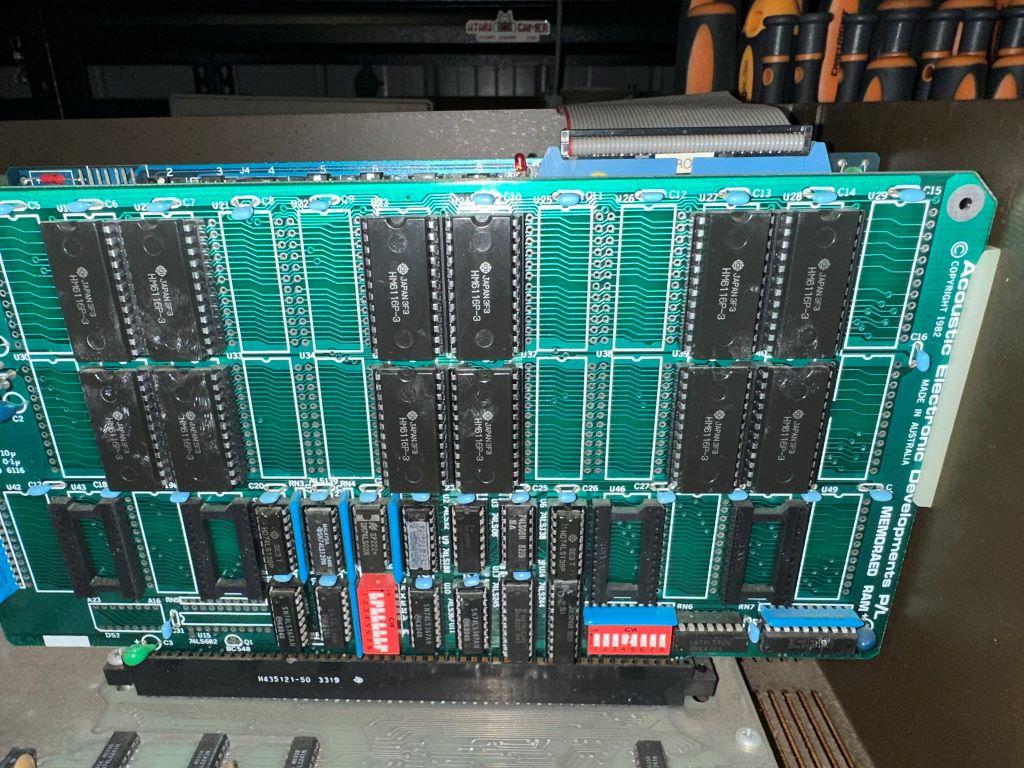

In the expansion unit there is an Acoustic Electronic Developments Memoraed RAM board. I'm guessing this is the 32k -> 56k ram expansion with an extra Rom?

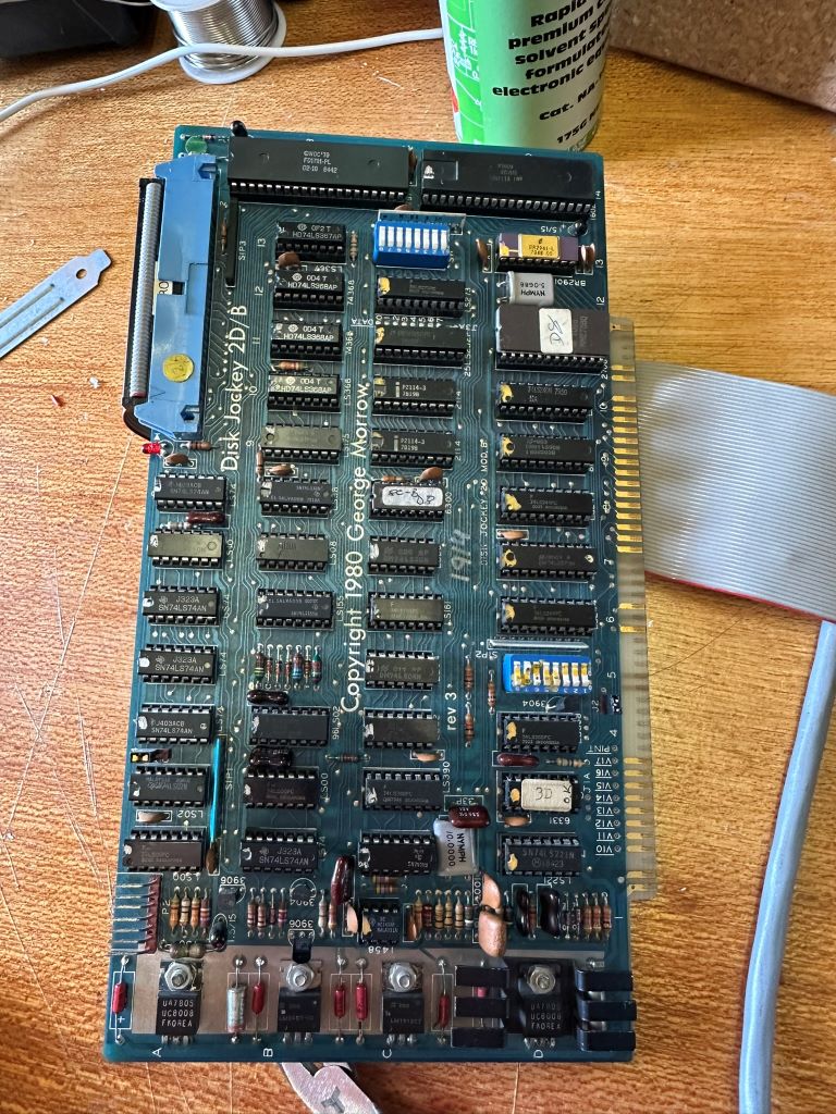

Can you upload a photo of the hard disk controller in the S100 expansion ? Would be interesting to see what controller this is.

I’ll take a look tomorrow, but I do know that they’re Morrow Design drives, so possibly it’s a Disk Jockey.

Ok, yes - its a Morrow Design Dick Jockey 2D/B.

With the expansion unit on, and then powering the Exidy on, I can see the ram goes from 7FFF to D7FF - so I have to assume the Exidy is "seeing" the Expansion unit and at least the memory card.
