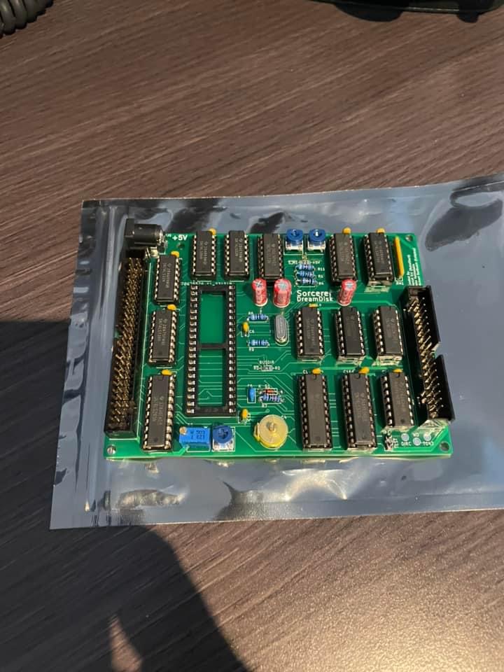

We have successfully designed, built and tested a replica of the Sorcerer Dreamdisk FDC here in Australia. It based around a WD2793 FDC chip.
It booted successfully from a Gotek using an 80 Track DS/DD 720K .DSK Image.

Also most Sorcerer's (MK1/MK2) have a factory fault on the PCB where PIN 6 (NMI signal) on the 50 way bus edge connector is not connected internally as there is a small 1mm pcb track missing. You need to remove the Sorcerer PCB and solder bridge a small link to an adjacent PAD to connect PIN 6 to the Sorcerer circuitry.
Apart from the above the rest is mostly plug and play.
Still not sure if these will be available as fully supplied kits (All parts, pcb, inc. eproms) or fully built. This will take some time to sort out.

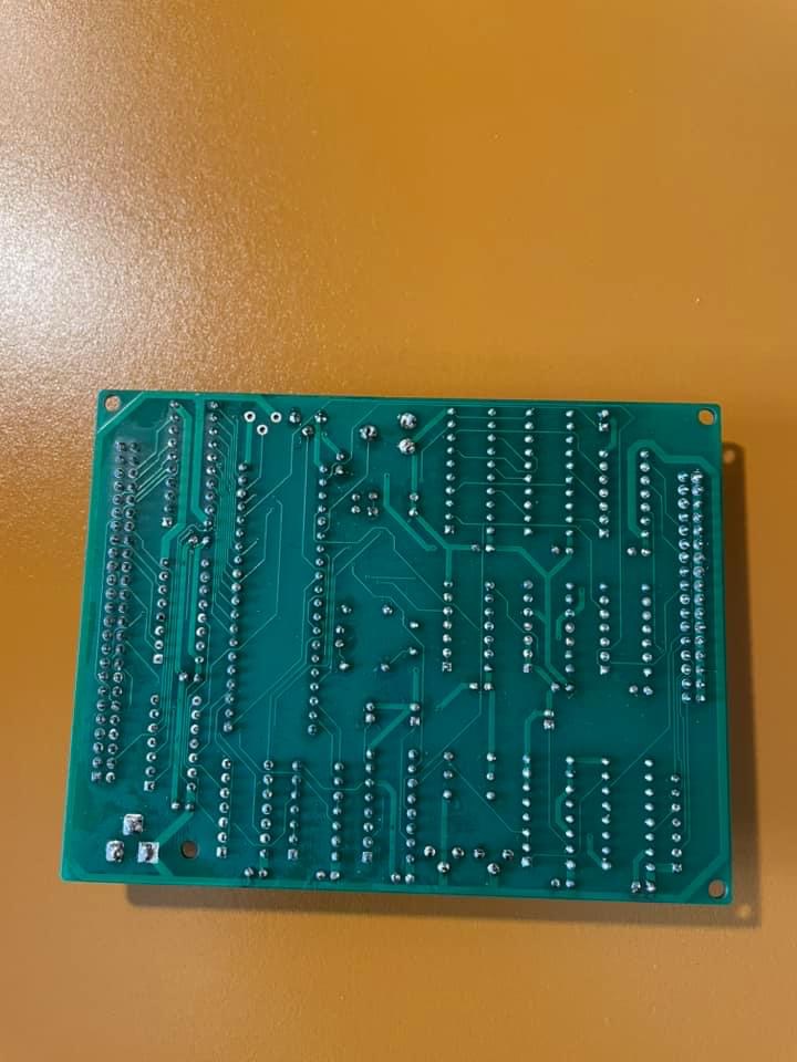

If you want to build your own - the gerber files for the PCB board design are on github (link above). I ordered 5 x PCB's (min. qty) from JLCPCB in China. There is a BIll of Materials spreadsheet for the parts which you can order from Mouser Electronics.
