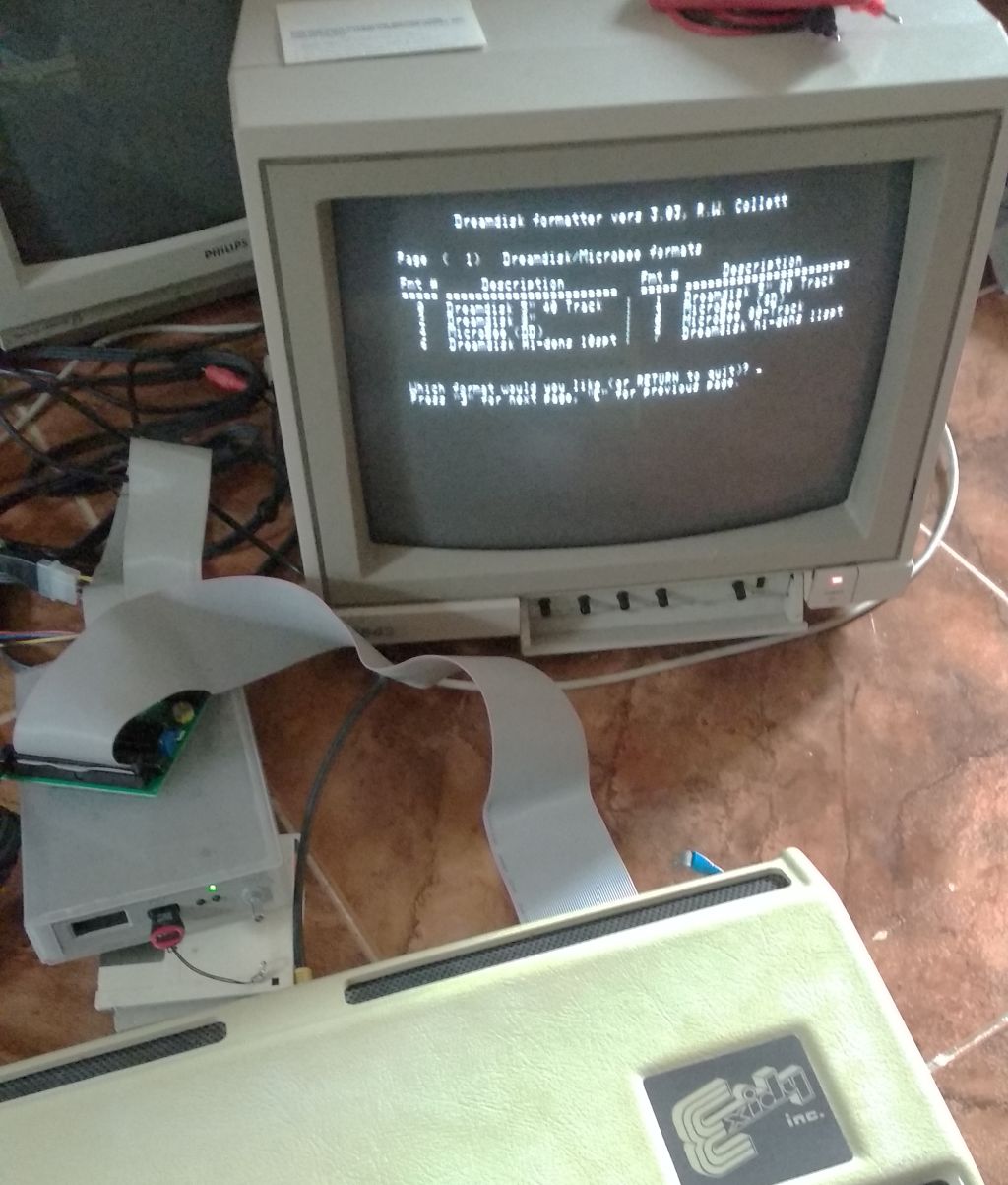

Well, after quite some work and a couple o months later, here's my new Dreamdisk FDC working!:
I'm sorry for the bad quality photo; but my hands were shaking :lol:
Not too much tested until now. Machine boots; but not all .COM files work; so I need to spend some more time with it. I want a proper case with a single power source for both FDC and Gotek and a shorter expansion cable.
My main problem has been my heavily modded Sorcerer, I'm going to open a new [url=https://www.exidysorcerer.net/index.htm ... p76}thread[/url] about it, maybe someone can shed some light about what's exactly inside my computer.
Now, I can share some knowledge about all of this so feel free to ask...

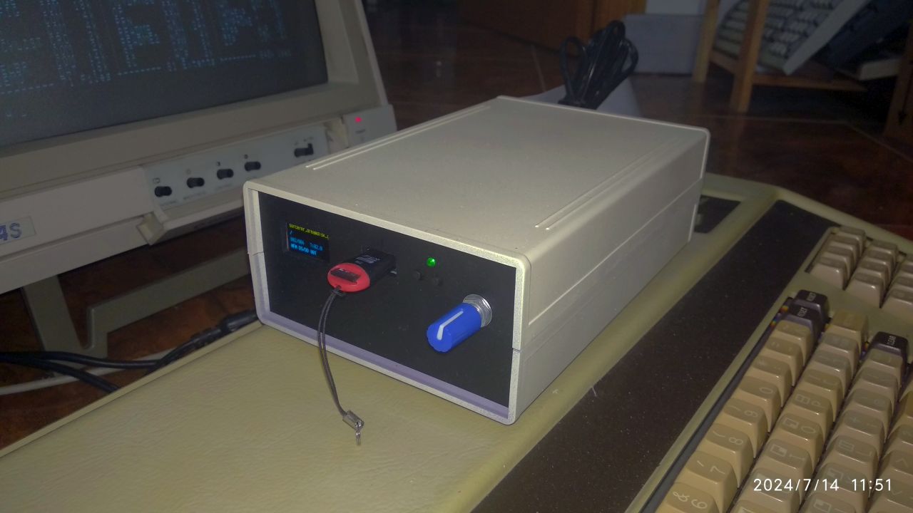

Just a little update to show what's probably my final Dreamdisk unit:
A prototype case, some creamy and black spray painting and a lot of sawing did the trick. It's powered with a 5V PSU and has its own rocker switch.
Maybe, if I find a way, I'll add some "Exidy" vynil in the front fascia. As for now I'm very happy with the result :)

Hahaha, it took me weeks!. I'm moderately skilled in electronics; but extremely clumsy with any kind of handwork. Anyhow, I can post here the box I've used, purchased in Aliexpress: https://es.aliexpress.com/item/10050056 ... pt=glo2esp
The controller and the Gotek stacked on top of it, fit really well inside the case :)

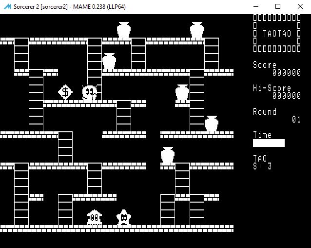

Yep, following ChickenMan's instructions in this thread I was able to edit existing images, or at least, add software to them. Soon I'll need to create new images from scratch as I've plans to use disks as the main media when creating games with my port of MPAGD to the Sorcerer.
Are any of you interested in "easily" programming games for the Sorcerer?. Right now, I'm testing the engine only with this game prototype:
