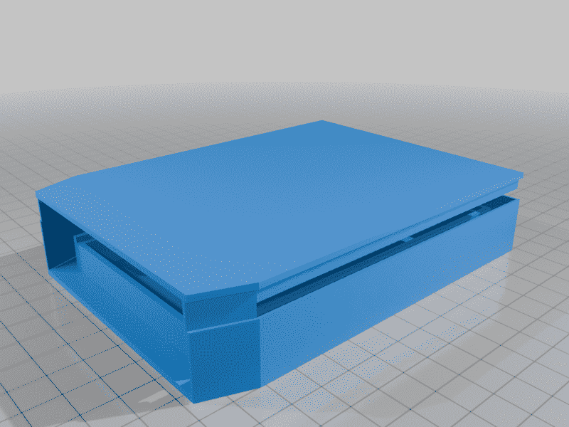

I've fabbed 10 of the rompac's, and built and printed 3d models of the rompac.
i wrote it in openscad, so it's easy to modify.
the repo for the rompac is https://github.com/cm68/exidy-rompac
I'll post a real picture of the assembled beast once the latest one comes off the printer.
i've also put it on thingyverse: https://www.thingiverse.com/thing:6963005

Fantastic, I'll link the 3d models in the original post if you don't mind.
zenxyzzy
Posts: 4
Joined: Fri Jan 19, 2024 12:36 am
Location: san francisco
Contact:
Re: ROM PAC replica boards
Post by zenxyzzy »
i've tuned it a lot since the original design. it clamps the original rompac board really well, and the new ones are mechanically identical.
