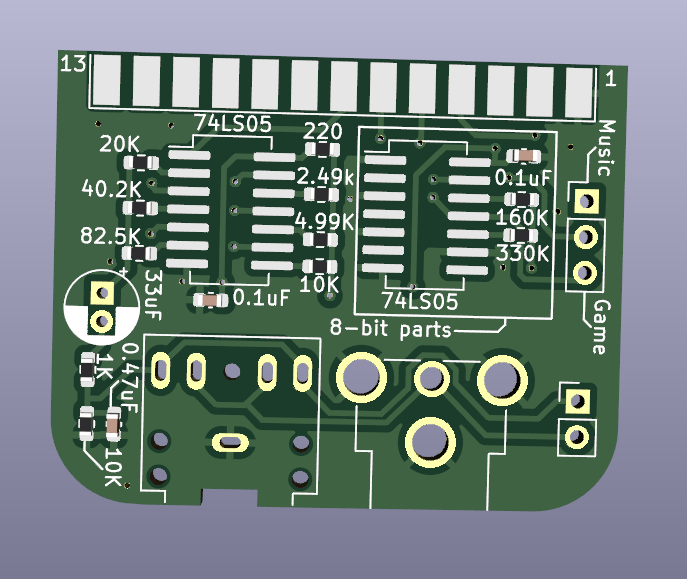

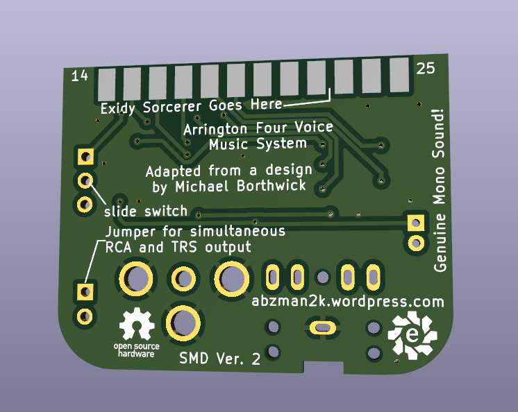

While assembling the last of the boards I originally designed I wanted some revisions to aid machine assembly and subtle-ly add features. Version 2 has:
  • Wider footprint for fitting two sizes of SOIC part
  • All parts on one side to aid machine assembly
  • using the switched function in the headphone jack to disconnect the RCA when headphones are plugged in
  • a bypass jumper for the above feature
  • properly labeled bit0 and bit1 resistors
You may notice that almost all the functionality is exactly the same, so I can't really think of much reason to want v2, I just did it because if I was going to do a second run maybe I'd fix some things.
I have updated the git repo, but nothing else yet because I haven't built and validated it yet, but here's a render of v2
