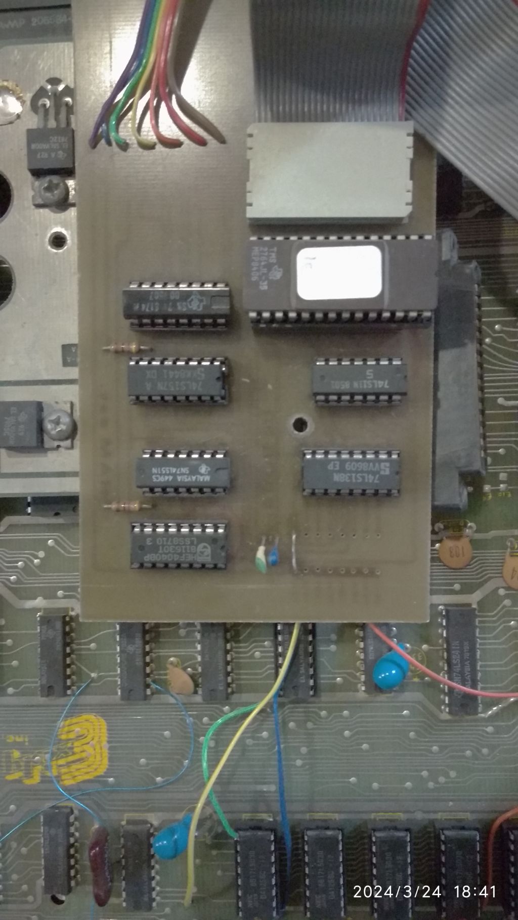

After building the Dreamdisk, the main issue I've found is the presence of this board in my Sorcerer:
ESGG EXTRAMDISK.jpg (204.03 KiB) Viewed 130599 times
It originally had a 2732 EPROM and a flat cable that goes to socket 1E, replacing the first Sorcerer ROM. The second ROM, 2E, was also replaced in the same motherboard. Seems that the contents of these EPROMs was a combo of "ESAG monitor 1.3B" + standard Exidy monitor 1.0. It booted with the 1.3B version and all worked fine.

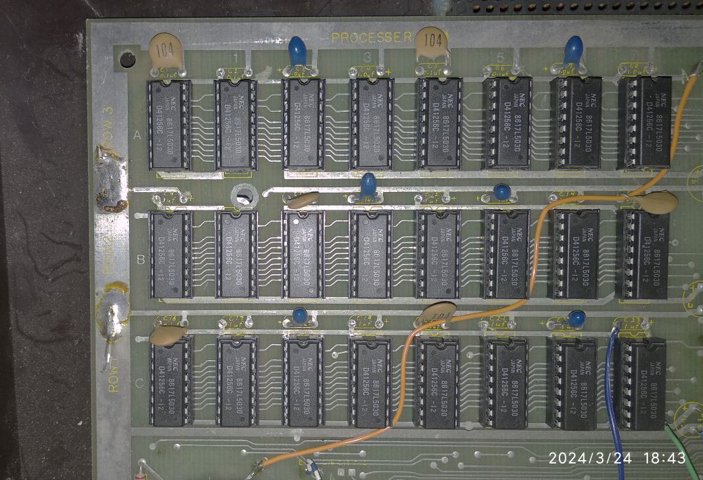

And yep, my motherboard has all RAM replaced:
I've always thought that it's only a relatively common mod to use 256Kbx1 ICs instead the original 4116 ones; but no, seems that there're some wires described in the manual and given that it's a RAMDISK extension, maybe it could be some kind of paged RAM expansión used as a RAMDISK??. Does the ESAG monitor adds some commands to make it work?

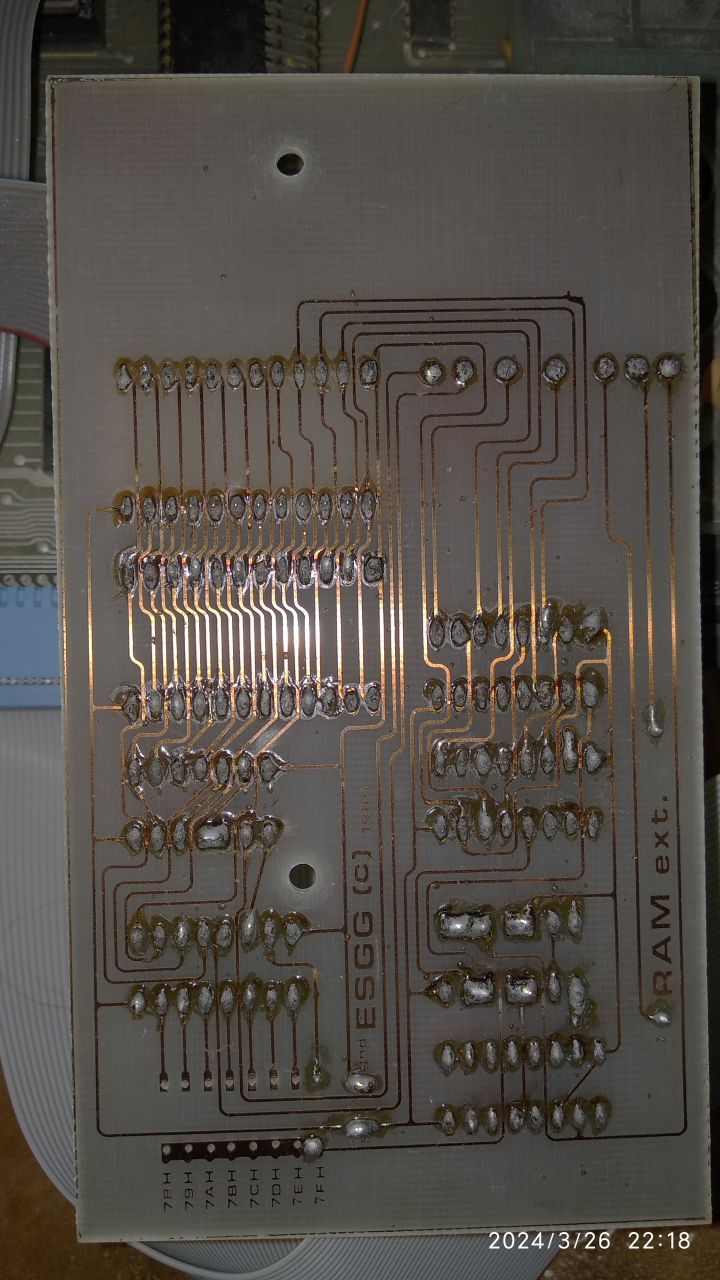

Btw, here're the pics of the back of the PCB and the motherboard wiring:

what sort of hacks are going on to get the 28 pin 2764 chips into the 24 pin spots on both the motherboard and the ram board? I don't think it'll end up being super important, I'm just interested now.

I think I understand the jumpering that makes it fit 2764 chips, but what's going on with A11 to switch between the monitors? Is it just hooked to a toggle switch?

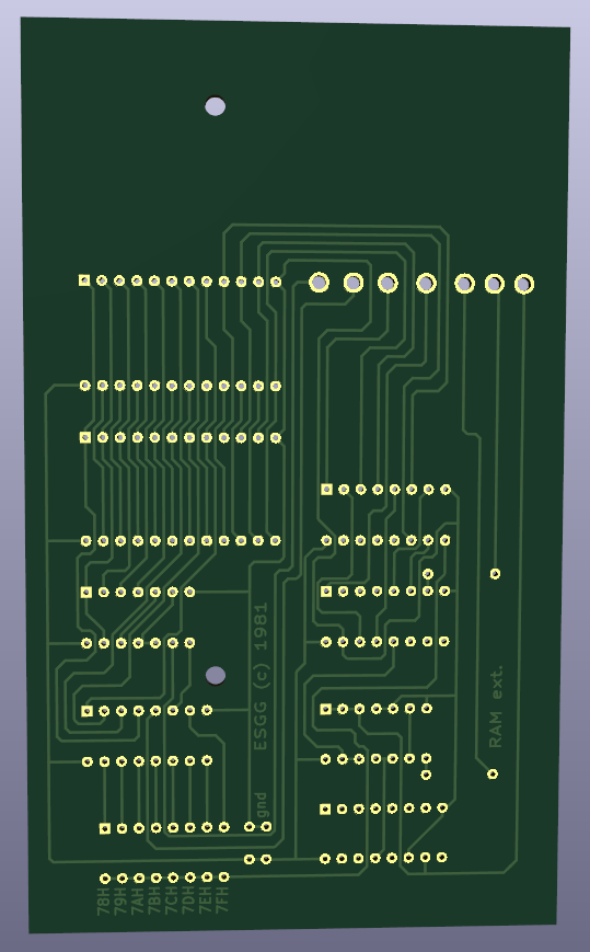

Once we figure out how to use this I'm tempted to make one. I already laid out a replica in KiCAD
